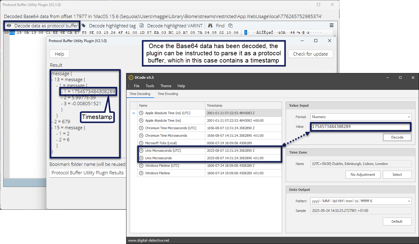

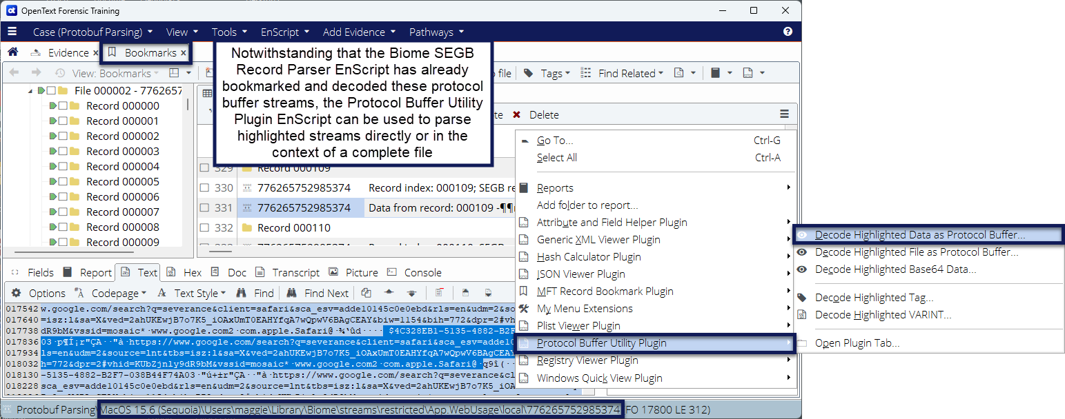

The script will parse the protocol buffer highlighted in the GUI. Depending on the option chosen, the protocol buffer must be highlighted from beginning to end.

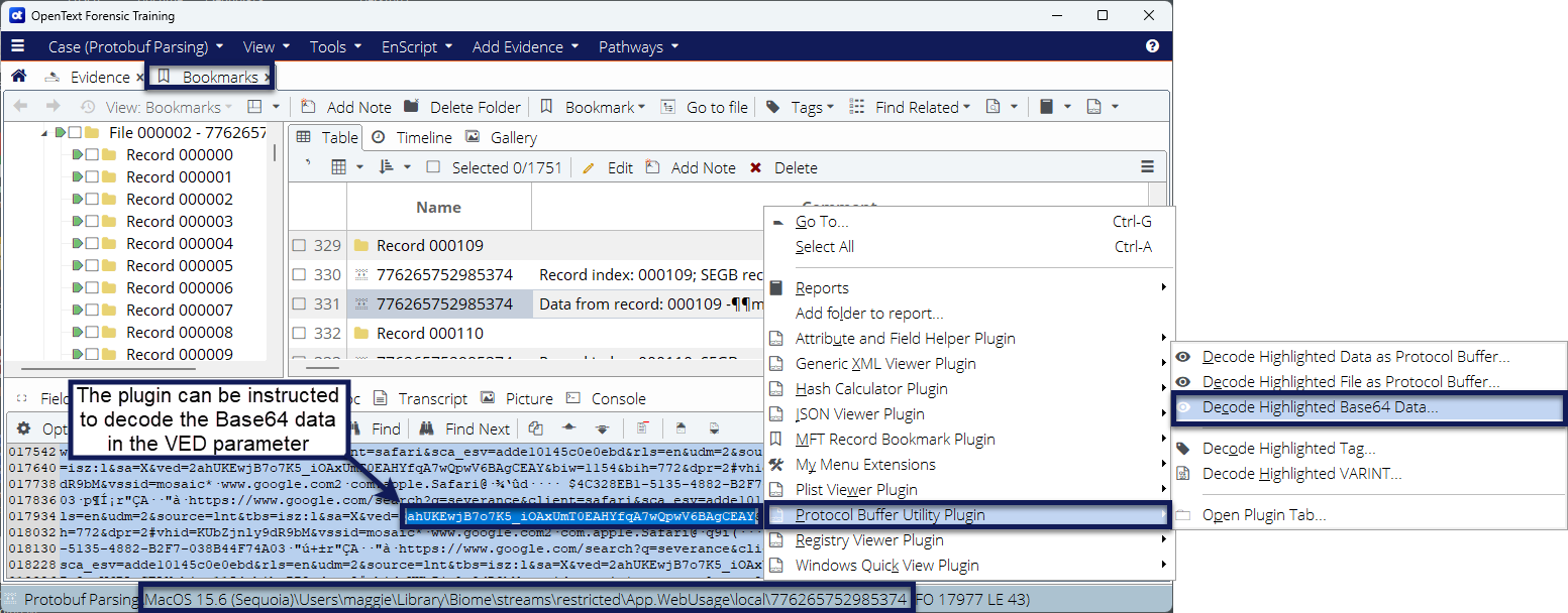

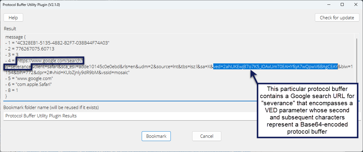

Given that protocol buffers are often to be found in Base64-encoded format. e.g., in Google Search URLs, the script also provides an option to decode Base64-encoded data, which can then be parsed as a protocol buffer (if that's what it is).
Note that the Base64-encoded ved protocol buffers in Google Search URLs will always be preceded by 0 (zero). This is not part of the Base64 encoded data.
